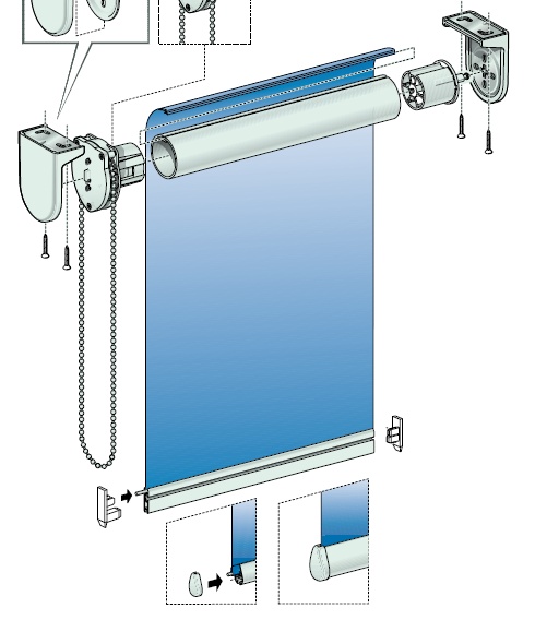

challange to make motion study for roller window
Dear all>
i have a challege to create a motion study for roller window ( see attached pic ) to determine the motor capasity and velosities >
i need your advice  how to represent the  fabric curtain ????
i tried many ways but till now all of them failed and the best of them was to separate the curtain to small slices and mate them togther in to points but it was very prossessing
consuming and always the solution don't complete
waiting your advice and thank you in advance ?

the workaround you described is the way that i think is recommended for things like rope. so that might be your only option.
the other option that i can think of is to use a force or spring of some sort to hold things together. it really depends on what you want to learn in the long run. if you're interested in having us take a look at it further to find a solution, drop me a line at jared@hawkridgesys.com.
