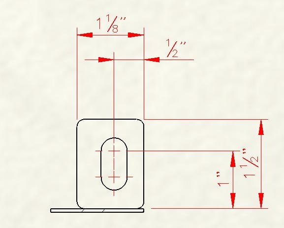

I have an annoying problem: I can't get the center mark to bein the center of a slot! I had a perfect drawing, now, after aminor dimension change, all my sections views don't display thecenter mark in the center. Please see image below.
No matter what I select, the center mark snaps off-center. I trieda few things like changing the display to shaded with edges, movingmy section line to force a view update, and even tried differentslot center marks to no avail.

You might have to sketch those in. I have had this happen tome too.

That is strange indeed. Can you repeat it on a simple testassy? Have you sent it in?

have you tried a force rebuild..?? Ctrl Q
SF
SF 2009-01-06
I have not been able to recreate it, but it does happen oncein a while.
I tried to force rebuild with a lot of hope but it still didn'twork.
I guess I'll have to do it manually for now.

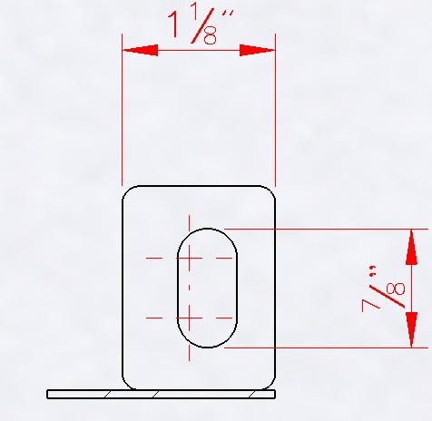

I am currently dealing with this issue as well.  This has happened to me when adding a center mark to a section view that was  created from a non vertical or horizontal section cut.

The inconsistency I'm seeing is in regards to placing centermarks at the center of a slot.  It is not a slot feature, but sketched geometry (a manually drawn slot, so to speak).  It was manually drawn because it was a modification to an existing part, with an extensive design table.  All of the slots on the part are sketched.  The software will recognise 90% as slots,  locating the centermark in the center.  There are a few that will only put a centermark at the slot ends.

2020 and this is still an issue sometimes, but i have a fix that sometimes works:
add the centre marks in, then delete the whole view and ctrl-z to bring it back, works 70-80% of the time.
AZ
AZ 2020-04-16
It happens to me sometimes when I am trying to mark center of a hole drawn by "hole wizard". I just remove the tick in the box "Slot Center Mark" under "Manual insert options" and it will be fine. So I suggest first mark the slot centers and then remove this tick and continue with the holes.
