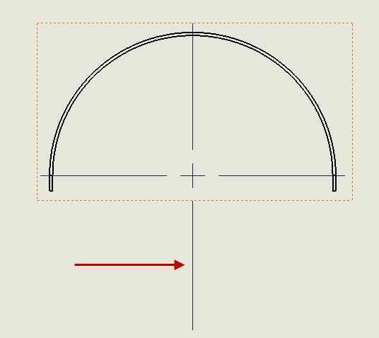

How do I delete this line?
I know its simple but its passed by me....searched but not really sure which keywords to use for relevant results.

Maybe I didn't make my question clear enough. All I am trying to do is delete the ONE line in the center mark that the red arrow is pointing to. I would like the leave the center mark and just omit the one line that has no purpose and hang way down.
SF
SF 2012-02-28
I think what you are asking, and everyone is missing, is how do you get rid of just the bottom line of the centermark that is outside the radius.  Short answer, you can't.  Longer answer, delete the centermark and add construction lines yourself.

You can extend the line but you can't retract it further than the hole edge. It would be a nice feature to delete or retract the line, send out an ER,

Hahaha its cool man. Thanks anyways John and Glenn. Atleast Wayne understands! haha
On a serious note, I cannot believe we do not have that functionality!!!
Had to draw it the way I wanted it by hand as suggested by Wayne.
Thanks everyone.

Sorry about the misunderstanding.  I had never tried it before and it's bizarre that you can drag that line longer but not shorter.
JE
JE 2012-12-12
Yeh, bizarre. I too have commented, and ER'd.
Today in SWK 2012 SP5 I still cannot shorten or scale the extension portion of CM.
Working the settings is fruitless for a comprimize.  BOTH elements are locked together in size-
Size   Specifies the length the center mark extends past the model edge and the size of the point symbol in the center.

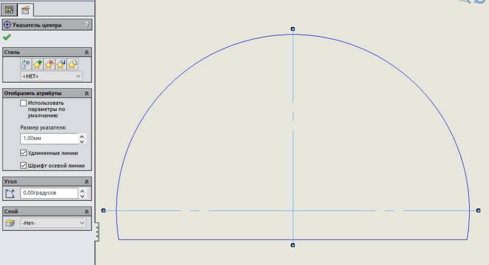

<span style="color: #333333; font-family: Verdana, 'Verdana Ref', Geneva, Tahoma, sans-serif;">Short answer, you can't.</span>
Pfff.....I can
Centermark is set using only Solidworks. No Photoshop or some image editing. Centermark NOT drawn sketched lines, that can be seen on PropertyManagerPage. The usual magic.
