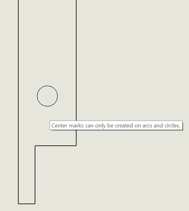

The solid is not positioned parallel to the major planes. So standard views on the drawing are slightly off, and the circular bores are seen in a bit tilted view.

Is it actually a circle? If it is a circle is the view of it perpendicular to the hole and not a tiny bit off?

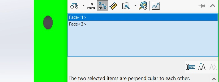

Hello yes it is. When using the measurement tool there is a radius value. I found a workaround to it by sketching a circle in the drawing file on all the circles. Afterwards I can put the center mark.

I would venture to say that View is not perpendicular to the hole.
