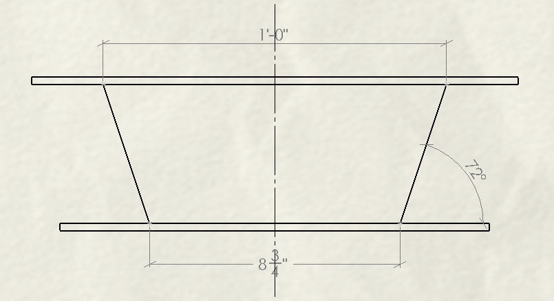

I am having trouble with center lines crossing over dimensionlines and their value. Is there a way to avoid this in SW? I amrunning SW 2008 SP 4.0.SolidworksDrawings And Detailing

yes, I did. I have edited the post.

Drag the ends of the centreline inside the dimensions.
KL
KL2009-03-03
Use theTools > Options > Document Properties >Centrelines/Centre Marks to set a smaller extension, and resaveyour drawing template(s). Then when the centrelines are insertedthey will not interfere with the dimensions.

Those are two good suggestions but for this particulardrawing and several others we will make we want the center line tobe long and actually go over the dimension without them actuallyinterfering.

Your only other option is to move the dimension textoff-center. Or centre.

Does anyone know if it is possible to create a backgroundmask in SW like you can in AutoCad? I know in AutoCad this does thetrick.

David Deyongh wrote:
Does anyone know if it is possible to create a background maskin SW like you can in AutoCad? I know in AutoCad this does thetrick.
Hopefully not. I use them in Illustrator and it's okay there,but in a multi-user CAD environment I would think you'd have a badproblem when things get moved and the mask gets left behind.
If I wanted a break in a centerline, I'd just draw or copy anotherline segment and add a colinear relationship. Ends can be adjustedto suit. To me that'd be the cleanest, quickest solution.
