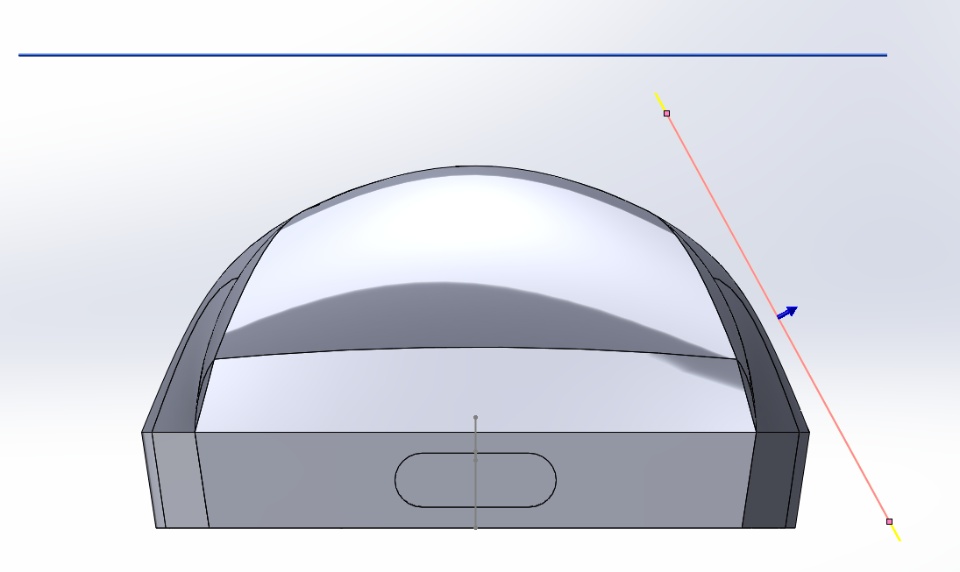

Hi Everyone, I'm new to solidworks and I'm trying to make a plane that lies against the right side of the mouse that i am making. I've tried multiple times but no result. If anyone could assist me id be very greatful.

It all depends 'just where' you want the plane
Here I use one of your vertices and a surface.
Where exactly do you want it?
comment imagecomment image

I'm not sure how to get the vertex, could you do step by step by any chance ?

You could always use Face Curves
then a ref point  ( you could use a sketch point) but maybe this shows better intent
now you can create your plane

<p>Barry Murphy wrote:</p><p></p><p>I'm not sure how to get the vertex, could you do step by step by any chance ? </p>
Just click it!
edit:  Can you describe exactly where you want it?

There are soooo many ways to do anything in SW
this might help... in a 3d sketch you have an onsurface relation

here's another way
sketch on top plane
make axis
make ref point of axis face
make plane

I got it, Thank you very much, much appreciated!
