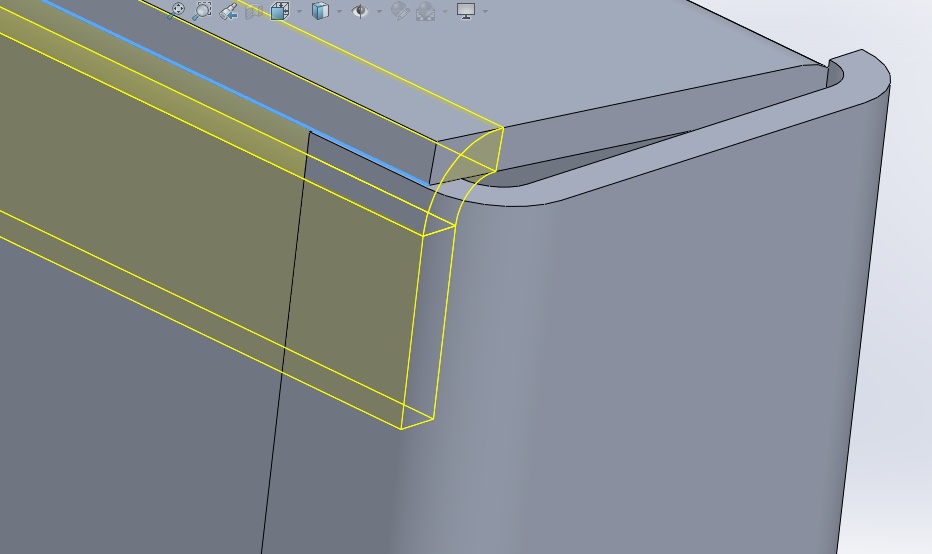

Hello,
I am trying to create and edge flange, however i keep getting an error that this is not possible.
The adjacent flanges are all 90-90, however the flange I am trying to create is 85-95
any idea why i can't create this flange?
Is there a different way of creating mitred flanges where one has a different angle to the rest of the folds?
Thanks
SolidworksSheet Metal
Answers 7
SL
SL 2021-04-08 Best Answer
The reason you get that message is because a single piece of sheet metal can't occupy the same space twice. The bend radius of the flange you are adding is clashing with the top of the front face of the box. Try more angle, or smaller radius or smaller thickness, or start the lid further up.

So I'd try to change the top flange so that it ends before the inside face and then do the last downward flange but as Scott has stated, they cannot occupy the same space.
