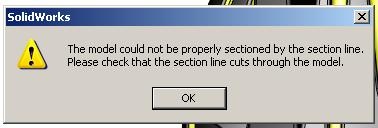

Cannot section a Part @ Part level
which results in not being able to section the aseembly as well.
The piece that are failing are both cylindrical and the origin is the center axis. I am using either front or right planes to try to section.
I am trying to figure out what features are causing the problems in the part files.
What has been your experiences with this problem?
I want to try to make sure it doesn't happen in the future.
Thanks in advance...

This has been an ongoing problem. I don't believe a definitive resolution has been found.
https://forum.solidworks.com/message/158020#158020
Sometimes the problem is solved by a reboot, but most times it's an unknown condition of a part or sub-assy. Perhaps the section is creating a zero-thickness? Or just a math-calculation bug?
The usual workaround is to offset the section plane by a tiny amount. Often .001" (or less) is enough.

I've tried the small offset without sucess. I cannot section anywhere in the Front or Right ways.
Top I can section them all day long.
I don't see any errors where zero thickness should be a problem, but it may be something tiny.

Is it only this one part giving the problem?
Can you post the part for review and testing on other machines?

Can you do an extruded cut instead of a section?

No, it is two parts in a 30 + part assembly.
That is part of the frustration.
One part had a cavity refernce the other part, but I broke all associations between them to see if that mifght cause thinges.
I am checking into the cavity area now (between meetings...)

An extrude cut @ the Assy level fails on those 2 pieces as well.

It must be a zero geometry thing.

I agree with Kelvin.  I have gotten this message numerous times when trying to create
a section, and usually what I am able to do is what Kelvin suggested and that is to
move the location of the cutting plane ever so slightly.  I do this until I get the section (or close to it)
that I am looking for.  What I have been told in my circles is this happens because there is some bit
of geometry that is not able to complete correctly (i.e. a spring being cut at a location it is not able to correctly
show its completed coil).  Kind of what Deepak is eluding to.
