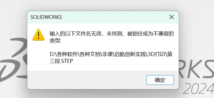

Why can't my SolidWorks open step. format files and prompt 'Invalid file name, cannot be found, locked, or incompatible type'? Is there any solution available

Try toggling "Enable 3DInterconnect" in System Options > Import, does this make any difference?

You can try to open it in eDrawings - to check this file.

I recommend trying to change the entire file path to regular Latin characters.  Sometimes the programmer of some module buried deep in the software forgets to think about supporting extended character sets.

I would start here.
where did the step file come from?   Sometimes I will need to download the file more than one time to get a file that will open.

Open thru the SolidWorks file explorer, file/open, not by double clicking in Windows Explorer.

Can you post a copy of the file here?

Have you tried moving the file to your C:\ drive, into a working folder only one folder deep, as in C:\12345\?  Also change the STEP file name to a single character, as in 1.STEP.

I have changed the filename to 2.STEP, and manually adjusted the filename in the STEP header with Notepad, can you try importing this one?
