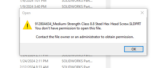

I am getting this prompt when trying to open any McMaster Carr parts I have in a folder. Any ideas on what would cause this?

Check the permissions of the folder. Move a failed file to a known good location to see if it opens from there.

Right click on the file, select properties and make sure it is not blocked by Windows. If it is blocked then you will see a check box with "unblock". Click the checkbox, and then try again.
OR share the file here, and we can verify the same.

This is what I am seeing in the file properties.

Can you send a screenshot of these file properties?

Here is the screenshot

There is the rub. You don't have access to the folder enough to read assigned permissions, much less, what's the folder and to open them. Repeat this on each folder level above to see if this repeats. You will need to add at least Read permission to see what's up. But Read won't allow editing or moving. With Read, you'll be able to do a Save As to some other folder (presumably one with full permissions).

I can open other parts that are in this same folder...it just seems to be the parts downloaded from McCaster Carr that I can't open.

Can you move them elsewhere? Right click a McM file and select properties. At the bottom of the Properties dialog, is an "Unblock" checkbox available? If so, tick it and click OK. Does it open now? If so, downloaded files are getting extra scrutiny or instead of asking you, your Windows settings (somewhere) are set to just block. If you have many to unblock, you can use MS' Sysinternals Streams to unblock all in one command line. BTW: Wild cards work with Streams, but not *.*. You'll need to do a batch by common extension, such as *.sldprt (which for this situation looks like the same thing). Streams downloads as a zip, which is an RC>Properties>Unblock first. Unblocking the zip unblocks its contents (otherwise extracted files will each need an Unblock). Extract the Streams files into your McMaster folder. Click the address in Explorer to highlight it and replace it with the letters cmd, then press Enter. This will open a command window at this folder. Type the command streams *.sldprt and press Enter. When the command line prompt returns, open a random part file to test, close the cmd window and delete the Streams files.

well...I'm not seeing a Unblock option when I RMB on the files.
