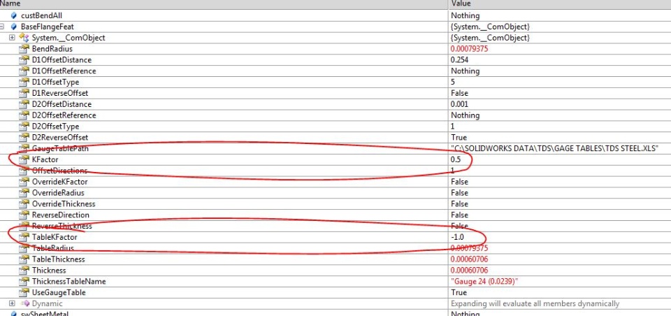

cannot get bend table k factor
I have been trying to get the k factor used by a sheet metal feature that utilizes a gauge table.  It looks like solidworks provides a few different ways to do this but none of them seem to work.  I think the root of the problem is that solidworks is not applying the k factor in my gauge table to the sheet metal feature, instead falling back on the default.  Anyone have any ideas what's going on?

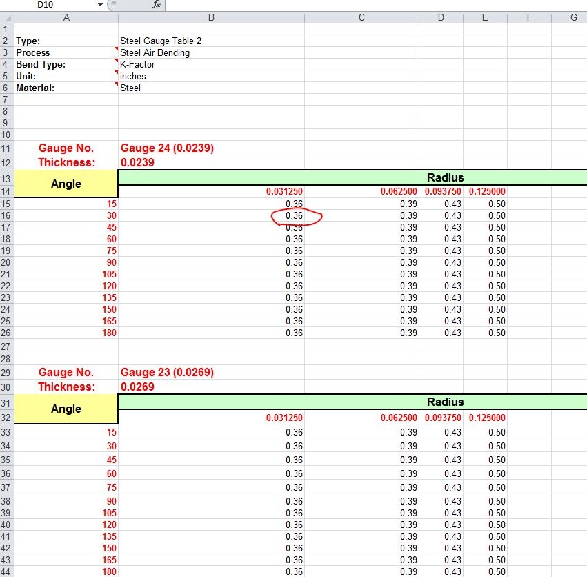

Here's what my gauge table looks like: (target bend and k-factor circled in red)
Here's my code (runs after a rebuild)

When I do a watch on swSheetMetal I get this:
Any thoughts?
