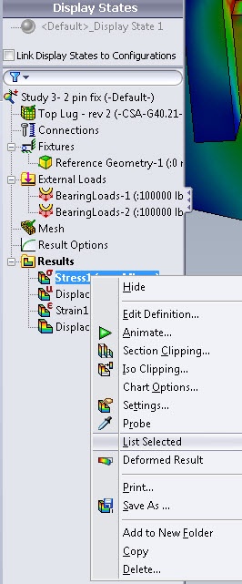

While i tried to find nodal stress on a selected entity, I could n't get any result. I used to do this on the following manner, so that this would get me all the nodal stresses on a selected entity, like edge, surface etc.
1. expand the result on simulation property manager tree
2. right click on stress
3.in the prob result result--> result  window selectect the edge or face

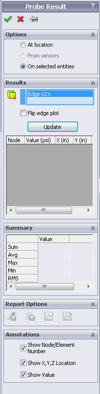

while i do this i get result as a table and in report option as a graph . but on some specific entities i didn't get any answer. Please help me to find a solution

what happens if you try probing those locations? what do you get from an output perspective?

hello Jared, i didnt get any result after clickig update button

My suggestion was to use the probe function.
Can you post the displacement results plot for the location you are trying to use list selected on.
Also have you tried plotting on the body or surface.

I tried plotting surface. i could nt get that .i couldnt even get the displacement plot. that particular edge or surface doesn't give any kind of probe result.

no results will mean no probe will mean no list results. sounds like you need to look at your setup and find out why there aren't any results there.
