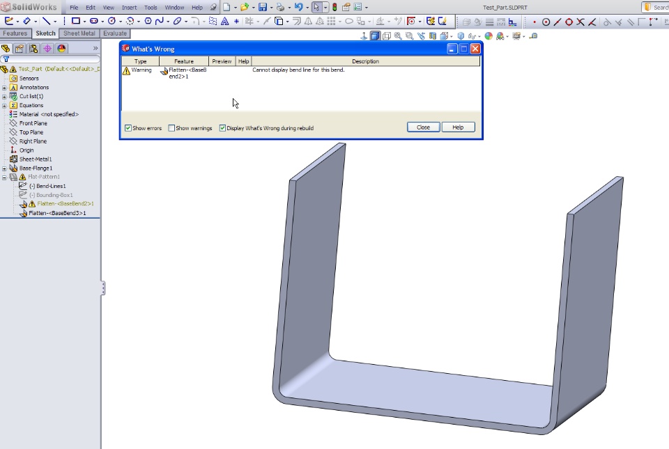

Error went away for me when flattening in SW2011-SP3EV
MP
MP2011-03-13
Thanks Kelvin.
Is this a bug in the sytem or was it something I did wrong? What about other parts that I will create, it will have the same error.

I didn't do anything other than open and flatten the part, so I have to assume it was just a glitch on your system. From what I could tell, you did nothing wrong.
Does this happen with other parts? is it repeatable if you recreate the same part?
What SP are you using?

Yes, all new sheet metal parts I create I get this message. I'm using SW2011 SP1 but this only start to happen today. Yesterday I worked on several SM parts and I did not get this message. I exited and restart SW and I still get the same warning on a new part. I'm going to reboot me computer and see what happens.

Kelvin,
I reboot my computer and all is well now. Not sure what was causing this.

I've read elsewhere that this error shows up when creating a base flange with 3 or more bends. Apparently this issue was patched in SP3, but I didn't get this error until upgrading to SP3....
Flattening the part and a ctrl-q rebuild solved the error for me.
