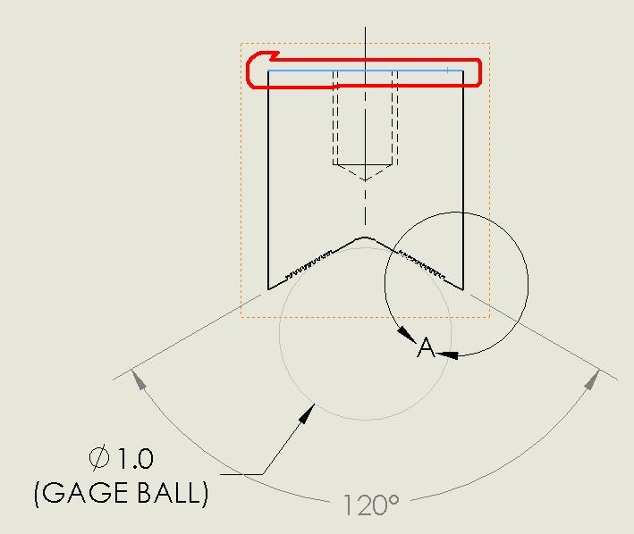

Cannot dimension to a drawn circle in my drawing.
I am baffled again.

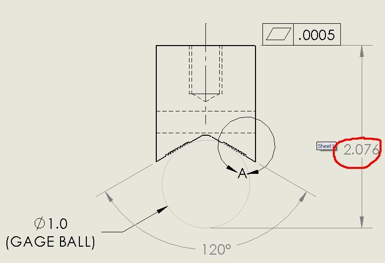

in one drawing, I can dimension from an edge to a quadrant of a circle I created within the drawing. (to show depth)
in a very similar drawing, I can't select the created circle. but why only this drawing. I can't make sense of it.
see attached. I've highlight the dimension in the perfect.jpg,. the highlighting in the 2nd picture indicates where i want to dimension from to the quadrant of the inactive circle.
I have solved this solution before, by actually creating a gage ball and mating it with the part in a assembly drawing, then I can select the circle.
but today I felt lazy, and just tried to see if a drawn circle would work. and it did, i was like WhaT THE?
so i tried on another drawing, and like before, it would not pick up the quadrant. I was holding shift while selecting the circle.
what am I missing?
Thanks for your time & reading.
Take care,
Shaun

SF 2009-11-13 Best Answer
This might be obvious but it happened to me... Make sure you have drawn the circle in that view.  I accidentally had a right side view selected while I was drawing a line on another view.  When I went to dimension to this line on the front view it would not let me select it bc it was in the other view.

Is the sketch circle created in that drawing view?
I'd activate the drawing view first (double click the view) then sketch the circle.

Thanks to both of you.
That solved my issue. must of had a different or no view selected.
