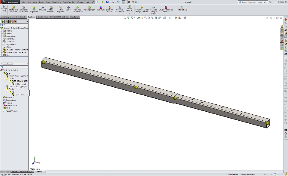

I have a simple static study of two steel square tubes, one partially inserted into the other, with only coincident interference.  SolidWorks isn't allowing me to select ANY surfaces to add fixed geometry.  All I have is four yellow circles representing "joints."  What am I doing wrong?

You are treating them as beams that´s why you have joints, add fixtures to joints.

Since I didn't want to treat them as beams, I selected "treat as solid" by RMB clicking the beams in the feature tree.  After "rebuilding" with Ctrl+B it lets me add fixtures like any other solid model.  Thanks for the help, Ingvar!
