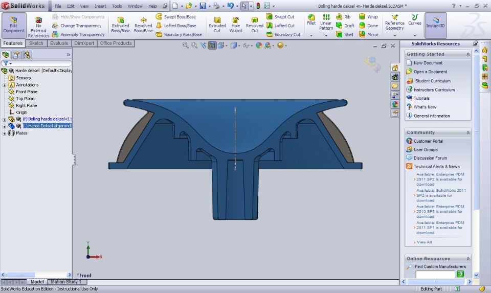

I want to merge two parts into one part, and I guess I should use the combine function. But the combine function is not clickable all the time. Does anyone know what I am doing wrong? There is a picture of the situation in the attachment.

The join function did it. But now I want to use it as a part in an assembly, but I can not make any mates with the joined part, is that because of it being a joined part?
How are you adding it into the new assy?
How are you trying to create the mates? Selecting ref planes or faces or ???
What error messages are you given?
Can you post images of the failed mate and/or the joined parts?
