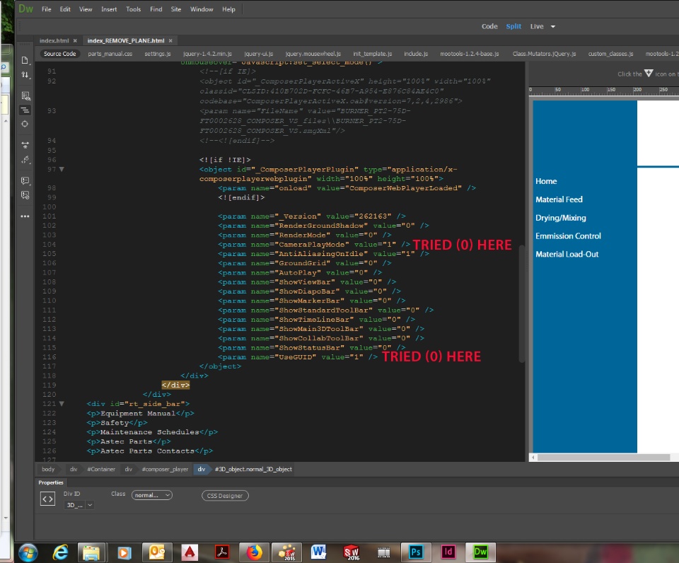

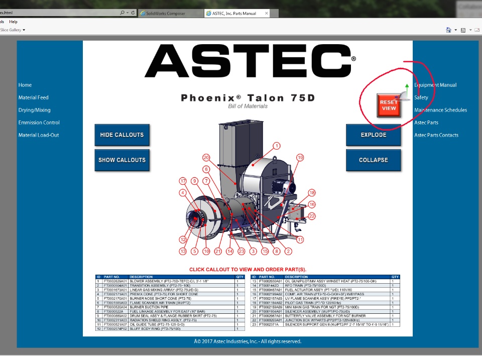

I'm creating a custom html page for the composer player. I can not get the Compass to NOT publish. I have unchecked the compass in the Composer tree and saved, and then published to html and it's still there. I have tried to cancel it out in the html code that embeds the player (see second screen shot) but no luck.
Is there a way to get ride of the compass?

Hi Kim,
try to do the following:
Change the Compass-Properties in Collaboration/Environment/Compass to
fixed in viewport: disable
Size 0
Set both to neutral properties
dont Forget to actualize the Views!
comment imagecomment image
KT
KT 2018-01-02
Thanks Dirk - that worked!
