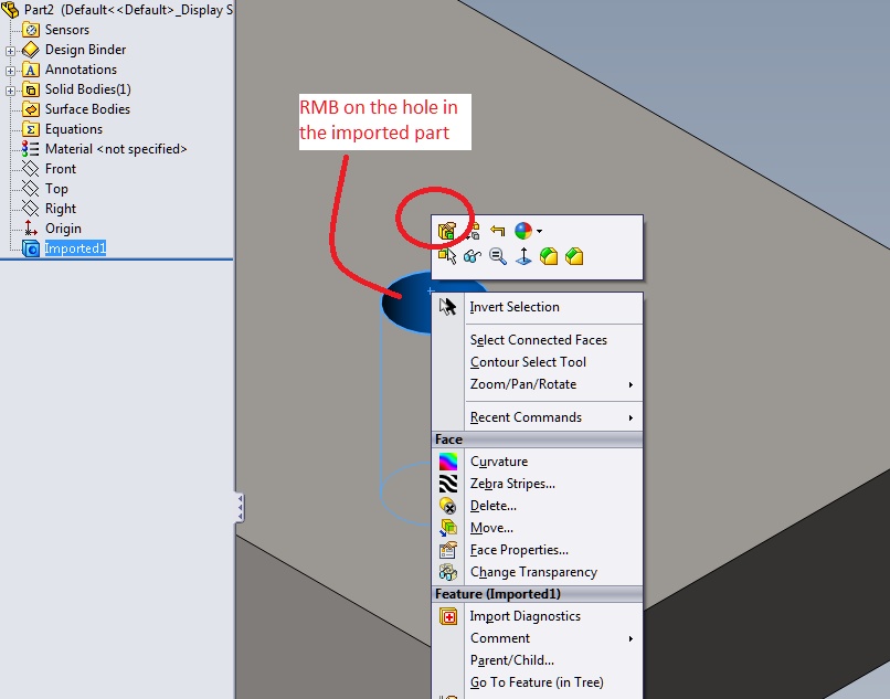

While you're waiting for your file, try right-clicking on one of the features (hole, fillet & so on) of an imported model.  If it's Featureworks-able you'll get the usual 'Edit Feature' symbol (see attached for an example) and SW will try and sort it.  This is 'Direct Edit' introduced in 2010 (I think).

I've tried editing the feature (as highlighted by Keith), but i get an error box saying "direct edit not possible. Part contains overlapping solids".
Featureworks cannot resolve the issue either.
I have a feeling the original file was an Alias file (or similar) as the majority of the model is surface modelling. I am also unable to thicken or convert to solids without an error box.
