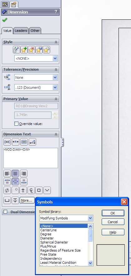

Can you attach a symbol (or text) to a dimension?
On our drawings, we want to add a Process Control symbol to a handful of dimensions.  Is there a way to attach or link the symbol so if you move the view or the dimension the PC symbol will follow the dimension?  You can attach geometric tolerances to dimensions via drag and drop.   Anyway to make custom blocks or symbols and do the same thing??

KL 2012-05-11 Best Answer
Use the Dimension Text > Symbols option
If the symbol you want to use doesn't exist, see http://www.eng-tips.com/faqs.cfm?fid=1229

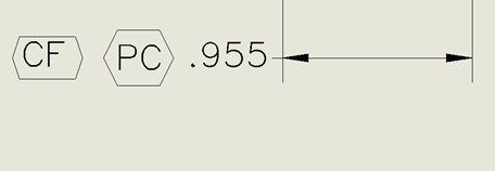

I haven't seen "PC" inside of a hexagon in the Dimension Text > Symbols.  We could use a flag, but that means changing our company standards, which is not ideal. I want what the continuous symbol looks like, just with a PC instead.  Is there an easy way to modify an existing symbol?  The gtol.sym file looks really intimadating, especially after reading note #2 on the link.

KL 2012-05-11
Open the gtol.sym file with Notepad
Find the CF, Continuous section, which looks like;
*CF,Continuous
A,TEXT .85,.5,C
A,TEXT 1.65,.5,F
A,LINE 0.,.5,.25,1.25
A,LINE .25,1.25,2.25,1.25
A,LINE 2.25,1.25,2.5,.5
A,LINE 2.5,.5,2.25,-.25
A,LINE 2.25,-.25,.25,-.25
A,LINE .25,-.25,0.,.5
Copy it to a suitable location (in the gtol.sym file)
Change to suit;
*PC,ProcessControl
A,TEXT .85,.5,P
A,TEXT 1.65,.5,C
Save the file and make a back up so that any customization is not lost when an upgrade is performed.
BG
BG 2012-05-11
Ok.  It worked...I had to figure out which GTOL file SolidWorks was pulling from (multiple locations were found in the search) but I got it to do what I wanted it to do.  Thank you!  (But the GTol file is still crazy intimidating--but I think I understand it now that I gave it a chance.)
