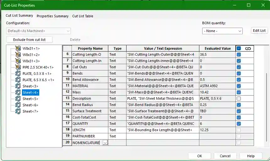

I've been adding the property "Nomenclature" to rename parts in the cutlist for the company I work for, but its getting a little annoying to add this property in the cut list each time, where do I go to add new properties?

Yes you can. click the edit list button at the top right of your properties that you show in your screen shot and add it in. You'll probably have to connect your cut list to it also on your drawing. Add a column with the new heading and connect it. Good luck, been awhile since I've done this, and it isn't something you do every day, but you'll be heading in the right direction.

You can apply this cut list property in bulk my right clicking the weldment feature in the feature tree and adding the property there.
You can use SolidWorks Property Tab Builder. Create a custom property for weldments (or modify existing). Then go to your System Options > File Locations > Weldment Property File
