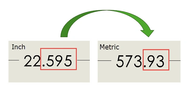

Hi Team,
 I am looking for code to set the tolerance precision -1 while converting units from Inch to metric?
  • If inch has 03 level of precision then while converting the precision set to -1 i.e. 02 Level.
Thanks for the support in advance! 🙂

In the document properties set the appropriate decimal places for primary and dual for dimensions.
JL
JL 2025-07-03
That would depend on if you changed the decimal precision manually or kept it at "Use Document Property" setting when adding the tolerance. If you manually changed it then the precision would stay between unit conversion
comment imagecomment image
ZS
ZS 2025-07-04
Thanks for the response but can we do this through VBA?
