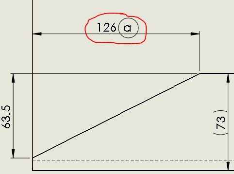

Can we create circular flag contains small "a" with dimension ???
I need to create this (below mentioned) dimension can anybody suggest how to make it.
Note:-alphabet must be small
Thanks

Yes.  Just modify gtol.sym.  You can copy the existing upper-case flags and just change to lower case.
AK
AK 2014-01-01
Hey thanx josh it worked..
