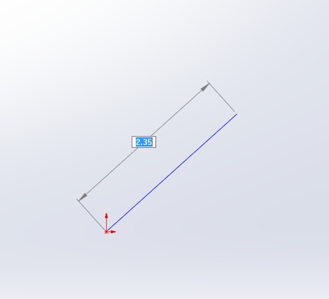

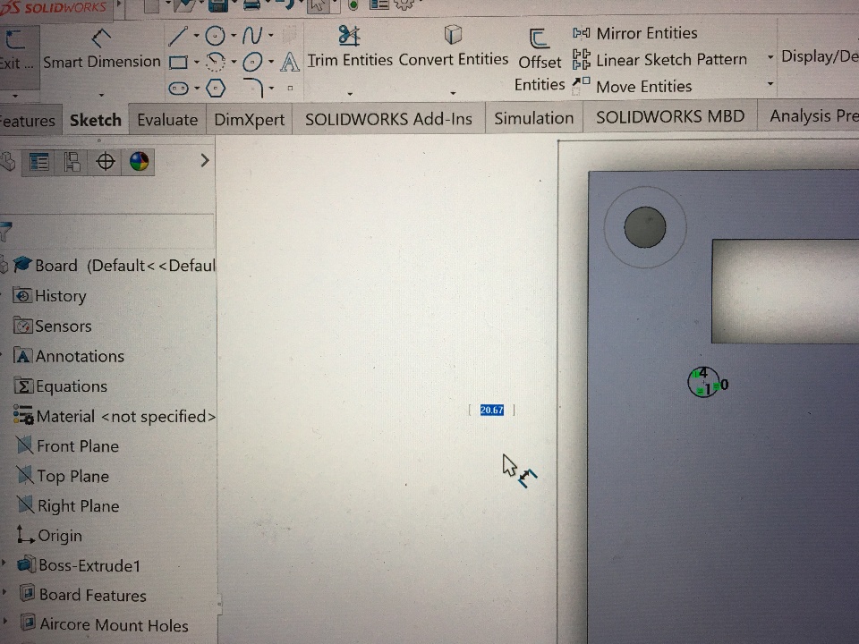

When I go into sketches in Solidworks my smart dimension tool is always on (even though the button in the tool bar shows it is off). Wherever I click, I click on a dimension to edit (see first two pictures - I clicked and didn't move my mouse, and a dimension box came up which is a dimension associated with the top left circle).
In addition, the dimension lines don't show up (see the third picture - this is what I want but don't have). This means I don't know what my dimensions are and I can't edit them as far as I know (for instance the positioning of the holes).

I had an issue with the smart dimension display within a part sketch, where it and the dimension lines disappeared upon entry, at first it thought it was graphics but it turned out that the dimension line font i was using (in my case Century Gothic) was missing. I resolved it by re-installing the font, but you could easily test whether it relates to this issue by changing the dimension font within your options and seeing if the issue is resolved?

That is what is causing me to not be able to see the dimensions, once I changed the font I could see all of them. Thank you!
