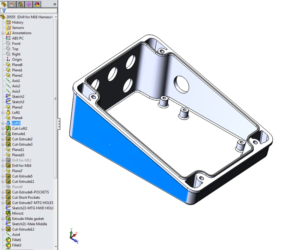

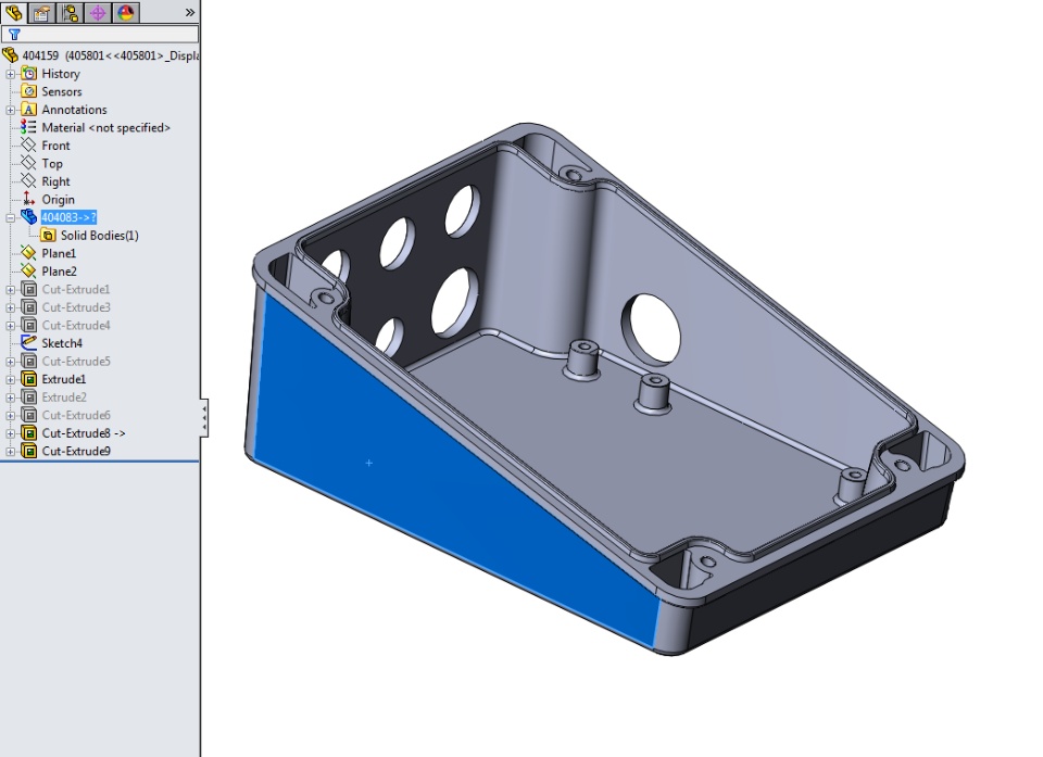

I'm modifying an existing model (cut a hole), and for some reason I can't sketch on the faces. I see it's a solid body in the model I'm using, so I got the original, and I can't sketch on that either. Confused, I made a simple lofted model myself, and I was able to select and sketch on any face. The goal is the hole in the second image, which I did on a plane instead of the face. Of course, I can't do a coincident mate to the face with the connector that's going in the hole because it's at an angle.

Without the file - my guess is that the face is not planar.

It's a loft so I bet you are right.

It seems to be a simple loft, and in other models I can sketch on the faces of lofts fine. I attached a Pack-n-Go to include both files.

Like J. said, it's not a planar face.

If you roll back to loft3 the edges are linear butthey do not all lie on the same plane

If I roll back all the way to loft 1 everything looks straight, but I still can't put a sketch on it. This is pretty confusing.

The edges are straight but they don't all lie on the same plane. The top sketch in loft1 is offset from the bottom sketch equally front to back. Since the sketch plane is at an angle the front and rear corners are at an angle to each other in two directions.

Since I can't change the enclosure I'll have just have to eyeball mating the connector, which I really don't like doing.
