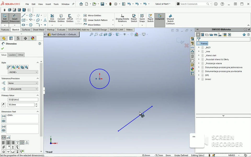

OK, I've switch back to my Polish language (after record this video) and all came back as it should be.

Check if you have perspective view set to on. If yes, then turn it off, and try again.

Interesting. I have seen this on drawings where the active layer is turned off and I will put 6 dimensions on a line before I look at the layers. Also the dia dim should have turned the circle black as in fully defined. Some things I would look at is how long as it been since the computer was restarted? How often is SolidWorks restarted? Usually when I start seeing this behavior it is getting ready to crash on me which causes the program to restart and then it works better.
