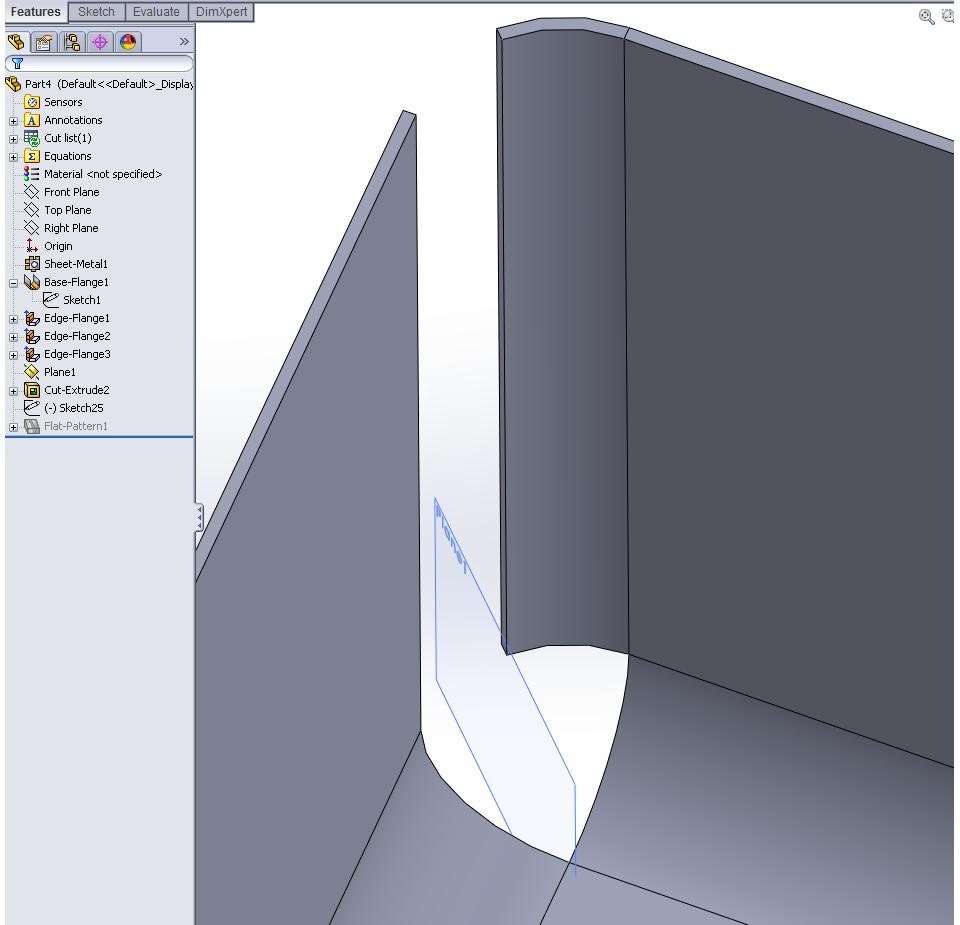

Can't mirror a flange that's been cut with an extrude?
Hi,
I'm trying to mirror one flange over a plane so that it will match the other side.  No luck.  The idea is to make a longer flange, and then use an extruded cut to make the flange an almost perfect fit.  I'm designing this way so that the radius can be changed in the future and the flanges will _hopefully_ update correctly.  Much better than having to edit each flanges angle and length each time I change a radius.
So, here's the one flange that's been cut.  I cannot get it to mirror.  I've had luck with similar features before.  Not sure why?  File is attached.

A miter flange will work better here, you cannot mirror a sheet metal feature that needs two linear edges with one of those cut off.
See attached example.

Jeff is correct.  to take it a bit further you can set the default radius to desired dimension and use it to drive all of the radii.  if you create the global variable "inside radius" and link it to the default you can now link the radius in the sketch for the miter flange.  make sure the sketch for the miter is on the inside edge.  add a dimension from the endpoint to "plane 1" (i used .0025") and voila all the bends update simply by changing the default radius value in the "sheetmetal1" feature.  :-)
hope this is helpful.

Thanks guys, I did find a working solution, just different.  I'll try building a model with the miter flange feature linked to the radius.  Hadn't thought of that.
I still want to mirror my cut flanges.
