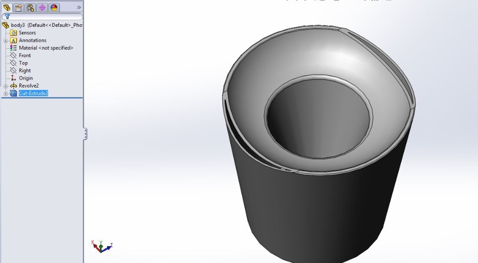

Hi guys,

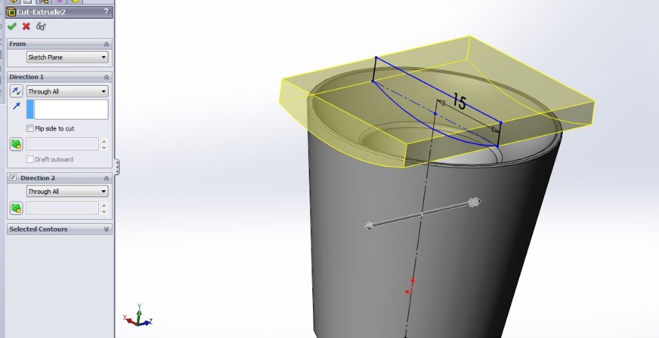

I'm having this revolved object and i want to make an extrusion but because it is like a shell, after extrusion is leaving me with empty holes and is there any way to create this like combine or something? Do you think i should create it as a solid and shell it after? but then are the other features which i didn't manage to create.
Thanks

SF 2013-08-13 Best Answer
I would do the shell feature last.
