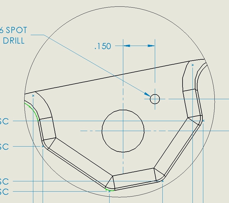

I'm sure I'm not the only one struggling with this.  I have created a cut from the top plane down with draft included in the cut feature.  The face cut is parallel with the top plane.  I then added a radius feature using the vertical edges created by the cut profile.  Why can I not import this model dimension into the drawing?!  I obviously can't add a reference dimension to this because the actual geometry edge created from the radius as seen in the top view is an ellipse.  So how do I dimension this??? The only thing I can think of is to add a custom property with the value that I want, create a global variable linked to the property, and then link the dimension to the global variable.  I can then add a note which references the custom property to get the proper value.  This seems a tad insane however.  Anybody have a fix that I am overlooking?

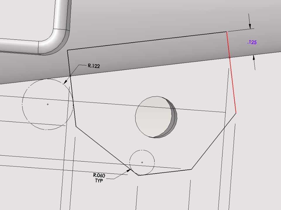

I'm familiar with this tactic and use it often.  However for a radius dimension this is not done as easily - there are really only a couple views that can appropriately show the dimension.  I've attached the detail view I'm trying to put this in.  The radii in question are highlighted.  These are 2 separate features.  I have also tried importing these into the parent view with no luck.  I found another workaround that is simpler than what I stated before.   I added construction circles in the cut sketch that "represent" the fillet features.  One could link the dims from the fillets to these dims to keep everything associative.  But this way I get model dims.  I can't just add the fillets to the cut because of the way the .122 fillet intersects with the curved cavity wall.  I'd have to add another feature to remove some left over material.  I've attached some pics of the situation.  For all intensive purposes I've found a suitable workaround - but any other suggestions are welcome.
