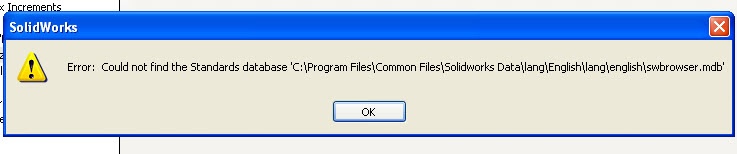

All of a sudden (since I have upgraded to SP 3.0 in sw2011) I now can't access my hole wizard.

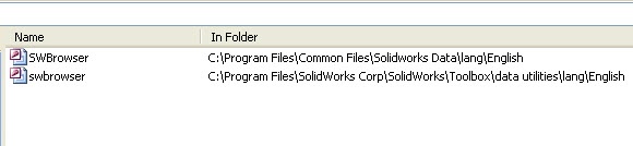

When I go to Tools>options>sustem options>hole wizard/toolbox configuration I go to browse
for this file it still says it can't find it.
Now what is interesting is that when I browse to the file in windows explorer it associates
it to MS Access even after I have changed the program type to open to be Solidworks.

SM 2011-07-21 Best Answer
I don't know why this is happening, but I just manually created the directory structure it was
looking for and it worked.  I am suspecting a bad install or something happened when I upgraded
to 3.0
