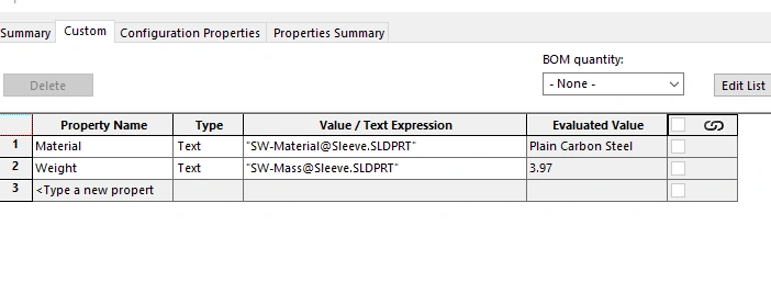

Why is it that I can't find material nor any part property actually such as weight in the list even though the part has the respective values set up in properties? Thxs all.
One way around it that I've found is to actually go into "File properties" and type it manually, but that's not the procedure that the training video says:

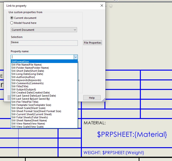

You are trying to link to drawing properties, and hence it is not showing up. Change the option to "model found here" in link to property window.
comment imagecomment image
AO
AO 2025-06-12
Same problem, mate, same problem.

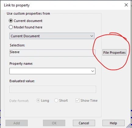

You are still doing it wrong. You are in sheet edit mode, so selected component option may not work. Simply set it to "drawing view specified in the sheet properties"

I want to point out that I'm working on the TEMPLATE. I do know how to work it out for a specific drawing of a specific part. I might get back to you this week. For now, I just need to complete my project. Cheers.
AO
AO 2025-06-12
Hi Deepak. It's working now with new parts. I don't know why but it updates automatically once I include the material in the parts' table. It's a mystery.
