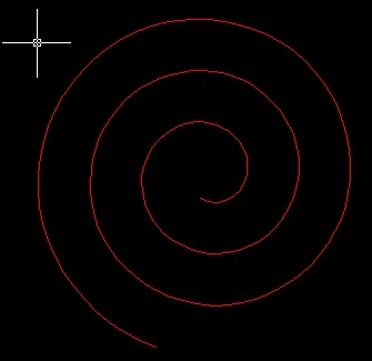

Hello good people;
I wonder if anybody knows whether Solidworks (R2011) can create a two-dimensional helix. This is not for bolt threads or gears, but for a pattern on a sheet of paper.  I did this in Autocad, but cad doesn't have the constraints that make SW so much faster.
Thank you in advance for your time

You can do it in SolidWorks, at least in a part, I'm not sure about in a drawing (I doubt it).  I'm working with SW2013 so you wouldn't be able to open an example if I posted it, but I believe SW2011 worked the same way.
First create a sketch on the plane where you want the spiral.  Sketch a circle and dimension it.  Close the sketch.  Then click on this sketch to highlight it and go to Features > Curves > Helix/Spiral.  When the PropertyManager appears select Defined by: > Spiral at the very top, then enter your other variables.

Sure, start a sketch on a plane say  top. Draw a circle 2.0" diameter. Exit sketch
select insert,  curve, helix spiral.
At the very top under defined by select spiral
input pitch, your revolutions and start angle. to change direction check the reverse direction checkbox.
comment imagecomment image

Thanks!  That did it
