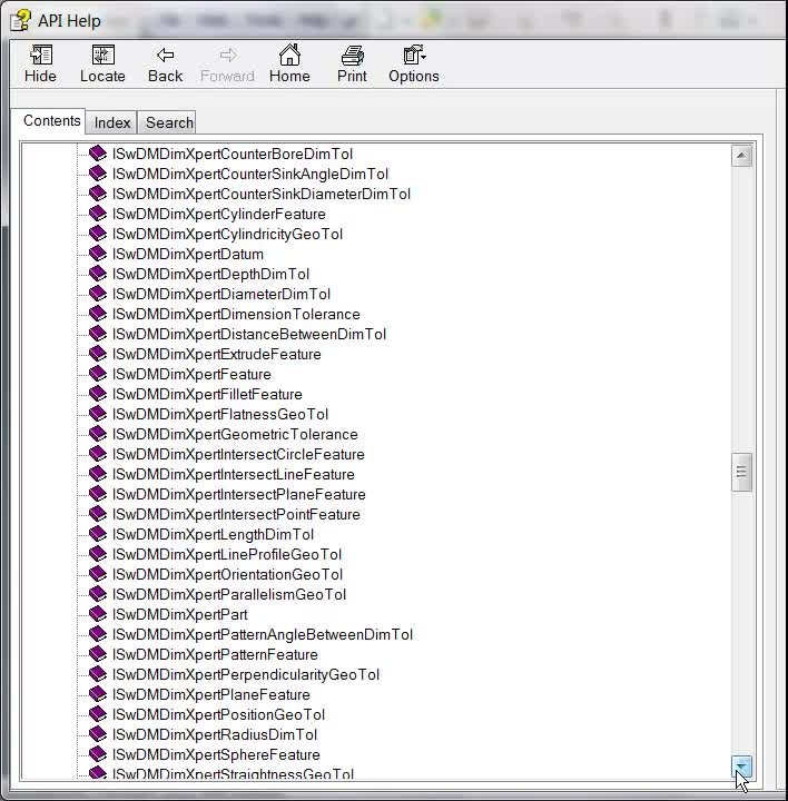

2. I believe you can open a sheet format file using ISwDMApplication2::GetDocument2, but I don't see any methods for extracting sheet format specific data. Please see attached. Of course, you never told us what type of data you're trying to extract from the sheet format file, so I can only guess. In the future, please be more detailed when describing your problem.

Thanks for the additional info. That isn't available via the Document Manager API, unfortunately.
