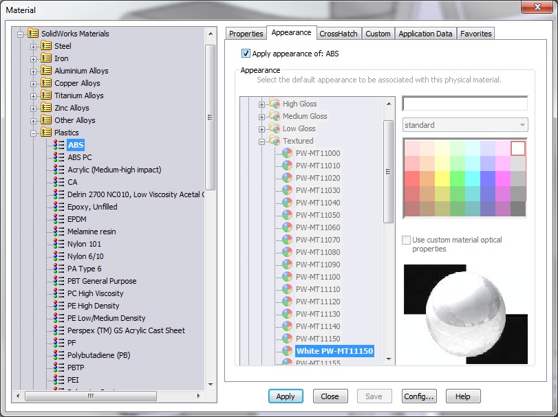

Can I set prevent the material appearance from applying when I change materials?
By default, when you change a material, the appearance that goes with that material is applied to the part also. In the Materials dialog under the Appearances tab, there is a check box to "Apply appearance of:". It remains in the last selected state throughout the session, but when you start a new SW session, it returns to selected. I'd like to be able to set a default if I could.

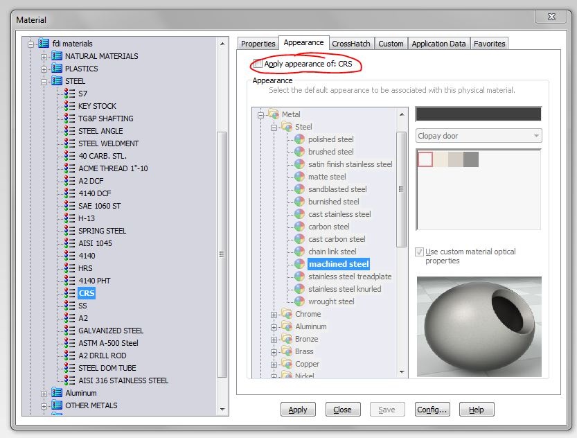

In the material dialog, under the Appearance tab, uncheck the "Apply appearance of:" box.

I don't know why the others were having problems, maybe something has changed from when they posted. But I am on SW2014 and all I had to do was open the part template, uncheck the "apply appearance" box in the edit material dialog, apply, and then save the template. Now when I create a new part I can apply another material and it doesn't apply the material appearance. The setting is saved with each part file. So if you have an old part that had that box checked, you'll need to uncheck it before you change the material.

Do you have a material applied in the template? I leave 6061 Alloy assigned in the template, and have the checkbox unchecked. Maybe the box only stays unchecked if there is a material applied.
What version of SolidWorks are you using? I am on 2014 SP4.0.
