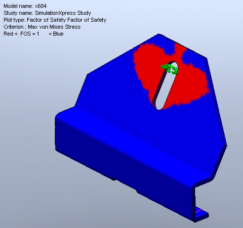

I just run a quick Simulation study suing SimulationXpress and found that FOS of the part is below 1 (red area of the part in the attached picture) and in my opinion, the part may not be safe to lift 2000 pounds.

Basically you should look at the Factory of Safety portion of the Results folder. If the red area extends to the outside of the material the potential for failure is there?

Simulation Xpress is a scaled down version of Simulation. You are limited in how you constrain your models and the results you see. It should only be used as a first pass analysis. The problem I have with it is that I do not know how accurate the results are with. It depends on how close you can simulate real world loading conditions. That being said, I cannot tell you what safety factor you should have on your part if you are using Simulation Xpress as the tool.
If you are using Simulation, then there are several questions to ask yourself when you intrepret your results. Do you have the loads and boundary conditions applied properly? Do you have a fine enough mesh in the high stress areas to fully capture the actual stress? Once you can answer yes to these questions, What will be the mode of failure? Will it be shear stress, tensile stress, compressive stress, or von mises stress?
If the part is subject to cyclic loading, then you either need to have your safety factor low or do a fatigue analysis on the part.
Here is results using Simulation using a hinge support and the safety factor is above 1 around the support but less than 1 inside the bend. When I ran with the default mesh size, the minimum safety factor was 1.26.

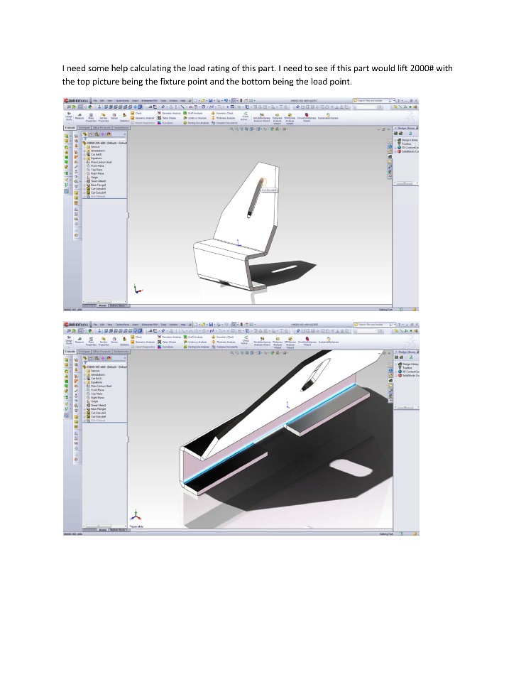

I had a structural engineer run the numbers, and he rated it at 1000 pounds. I do not know the safety factor he applied, but just lookng at the part I figured it would be more. I plan on having the part sent off and certified with a load rating by an independent company before going into production. That being very costly, I want to optimize the design to handle as much weight as possible, and not being an engineer but a product designer, I am having trouble understanding the results simulation express gives.

to understand the problem, need to know
1. the interface for the slot/flange, is it clamped along the length of the slot.
2. direction of pull. i.e is it parallel to the slot or along y or?
3. interface to load. how does is the load supported by the part?
otherwise you are throwing darts.
best,
dave
