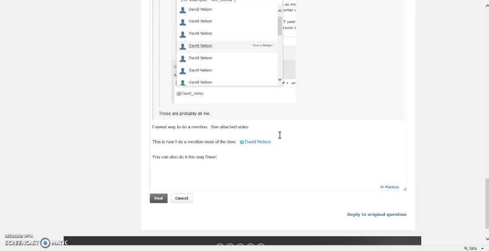

SF
SF 2017-07-20
<p>"What were they thinking."</p>
Obviously, they weren't. I probably should have mentioned earlier, engineers should not only have to learn to make the parts they're going to design, they should also have to do basic maintenance and repairs on the assemblies they create. :twak:
BTW, hope Mention was to the right David Nelson LOL!!!
comment imagecomment image
SC
SC 2017-07-20
Wow, that's the most same named persons I've ever seen.
Steve C

DN
DN 2017-11-02
<p>Matt Finley wrote:</p><p></p><p><a _jive_internal="true" data-containerid="-1" data-containertype="-1" data-objectid="11523" data-objecttype="3" href="https://forum.solidworks.com/people/1-9NPULG" data-community-id="1">David Nelson</a>, </p><p style="padding: 0px; min-height: 8pt;"></p><blockquote class="jive-quote"><p>"What were they thinking."</p></blockquote><p>Obviously, they weren't. I probably should have mentioned earlier, engineers should not only have to learn to make the parts they're going to design, they should also have to do basic maintenance and repairs on the assemblies they create. :twak:</p><p style="padding: 0px; min-height: 8pt;"></p><p>BTW, hope Mention was to the right David Nelson LOL!!! <span class="emoticon-inline emoticon_confused" style="width: 16px; height: 16px;"></span></p><p style="padding: 0px; min-height: 8pt;"></p><p></p>
Those are probably all me.
DP
DP 2017-11-02
<p><a __default_attr="184483" __jive_macro_name="user" class="jive_macro jive_macro_user" data-orig-content="David Nelson" href="" data-community-id="1"></a>  wrote:</p><p></p><blockquote class="jive-quote"><p>Matt Finley wrote:</p><p style="padding: 0px; min-height: 8pt;"></p><p><a _jive_internal="true" data-containerid="-1" data-containertype="-1" data-objectid="11523" data-objecttype="3" href="https://forum.solidworks.com/people/1-9NPULG" data-community-id="1">David Nelson</a>, </p><p style="padding: 0px; min-height: 8pt;"></p><blockquote class="jive-quote"><p>"What were they thinking."</p></blockquote><p>Obviously, they weren't. I probably should have mentioned earlier, engineers should not only have to learn to make the parts they're going to design, they should also have to do basic maintenance and repairs on the assemblies they create. :twak:</p><p style="padding: 0px; min-height: 8pt;"></p><p>BTW, hope Mention was to the right David Nelson LOL!!! <span class="emoticon-inline emoticon_confused" style="width: 16px; height: 16px;"></span></p><p style="padding: 0px; min-height: 8pt;"></p><p></p></blockquote><p>Those are probably all me.</p>
Easiest way to do a mention:  See attached video:
This is how I do a mention most of the time:
You can also do it this way Dave.
