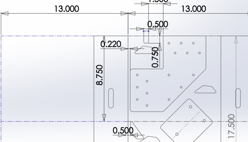

can I hide all dimensions while in sketch mode?
Any way to turn off all the dimensions temporarily while sketching?  Too many dimesnions get in the way of designing sometimes.  See pic

Till SolidWorks 2013, I didnt encountered such feature for hiding dimensions. Still I do provide you below 2 options
1.     Make use of an option of scaling the dimension, by unmarking always display same text size.  For details pleas see below image.
2.     Else make use of multiple sketches in part, to avoid the difficulty and clumsyness of sketch entities or annotations. So once you completed multiple sketches and you still want a single sketch out of it, then make use of Onedge relations or convert entities or all the sketches once in single sketch, you wil be having your required result.
Hope this will solve your problem.
Thanks
Sandip Darveshi.

I'm not aware of any way, and can't find any way, to hide dimensions in an active sketch in a model.  Forgive me if this is a silly question,  but I see you have dimensions right on top of sketch entities.  I assume you know you can click and drag them off to the side (or above or below, depending on position)?
MM
MM 2013-09-10
Great suggestion.  Thank you very much.  Still....I would be nice if you could toggle the annotations on and off while sketching.  All the clutter can get in the way of designing
