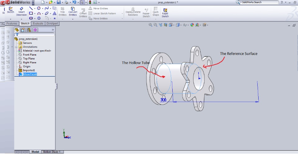

I tried what you suggested, and the program does something strange: the "move face" is registered on the design tree, and when double clicked shows a dimension that reads 10mm (the amount i wanted to elongate by) starting from the center of the tube, but no elongation is visible, do you know what can be causing this?

I'm not sure I can trouble shoot that from afar. Can you upload the .sldprt file? Maybe a screen shot if you can't?

Ok, heres a screenshot, perhaps you can see what went wrong.

Move face should work, but I'll elaborate on the split/move/join technique...
Start a sketch on the plane that is parallel to the hollow tube.
Sketch a single line that crosses the tube (perpendicular to the axis of the tube), it dosen't need constrained or closed...just a line.
Select insert> feature> split, you should see the current sketch selected in the "trim tools" box, click "cut part"
This should leave you with 2 "bodies", one on each side of the "split".
Select insert> feature> move/copy, and select one of the 2 bodies you just split, then type in the distance you want to extend the pipe into the appropriate cell.
Create an extrude feature on one of the tube faces you split previously, to fill in the gap between the bodies.
MK
MK 2010-06-17
If all you're wanting to do is make the cylindrical section of the part longer, here's how I'd do it:
1.  Make a rectangular cut in the middle of the cylinder to cut the part into two bodies.
2.  Use 'move/copy bodies' to move one of the new halves a distance along the parts axis.
3.  Extrude the cylinder profile to join the two halves.

thanks guys, the split/move method worked great for me:).
