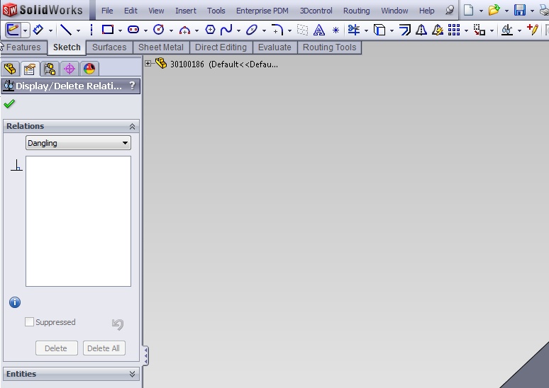

Bonnie,
If you edit the sketch and select the Display/delete Relations icon (its the one shown in the attachment that looks like an eye-glass). This will open up a window in  your Property Manager. You can use the drop down menu to select dangling dimensions and delete all or one at a time which ever you prefer.
SF
SF 2011-07-06
OH, I can delete them in the model?  I was referring to the drawing.  I am out of SW for the night (VPN connection) so will look into it again tomorrow.
thanks for the input!
Bonnie
