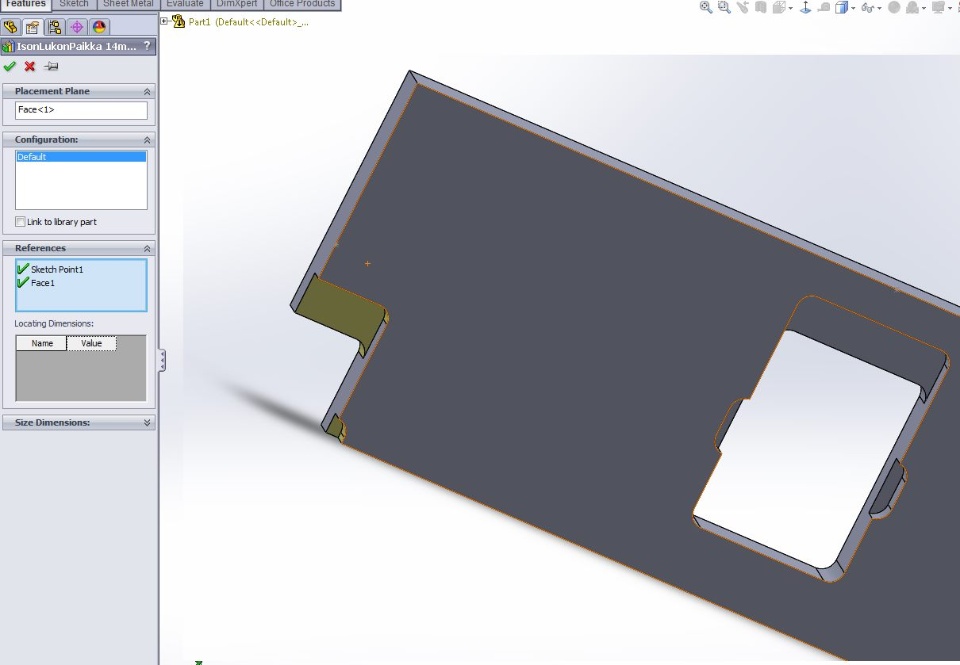

I have a library feature which cuts a hole for a lock. It is dimensioned 27mm from the edge (must be exact). And now when I place this cut it is always in the same direction. Can it be rotated 90 degrees from original position? In the image the right cut is correct, but i want to turn that left cut 90 degrees counterclockwise. Or do I have to make different features for each direction?

that will depend on how the library feature was made. in general, they can be made such that the direction can be determined by your selections when inserting the feature. mostly this is done by avoiding horizontal and vertical sketch relations - use perpendicular and paralel instead.

The key to creating a single library feature that works in both directions is to create it in such a way that it can be position both directions. Instead of using horizontal or vertical use perpendicular. When you drag the feature in from the pallete it should ask for the 2 reference edges. These edges will determine whether the feature is horizontal or vertical.
