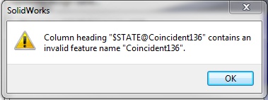

i continually get error messageslike the one below when editing a design table that SW2010 creates. i cannot figure out why the offending feature is an issue. until this is fixed SW ignores all edits to the design table and "does not update" it.

i've run into that before when i had leftover mates in my design table which i had previously deleted in my assembly.

If you have not made any changes affecting that mate in anyway, and the mate is still in the feature tree, I would delete the column with the problem close the design table rename the mate in the feature tree, then add it to the design table and see what happens.
When you edit the Coincident136 mate, are the selections valid?

i deleted the columns that were giving me an error. next time i will checkto see if the mates even exist.

I've gotten this messages similar to this lots of times. Usually it's because I generate a Design Table, then go back to the part and make some design changes. If I change a dimension name or a feature name and it isn't the same as the one I first created , the error message appears. It normally corrects when I delete the entire column, and then re-link the dimension or feature.
