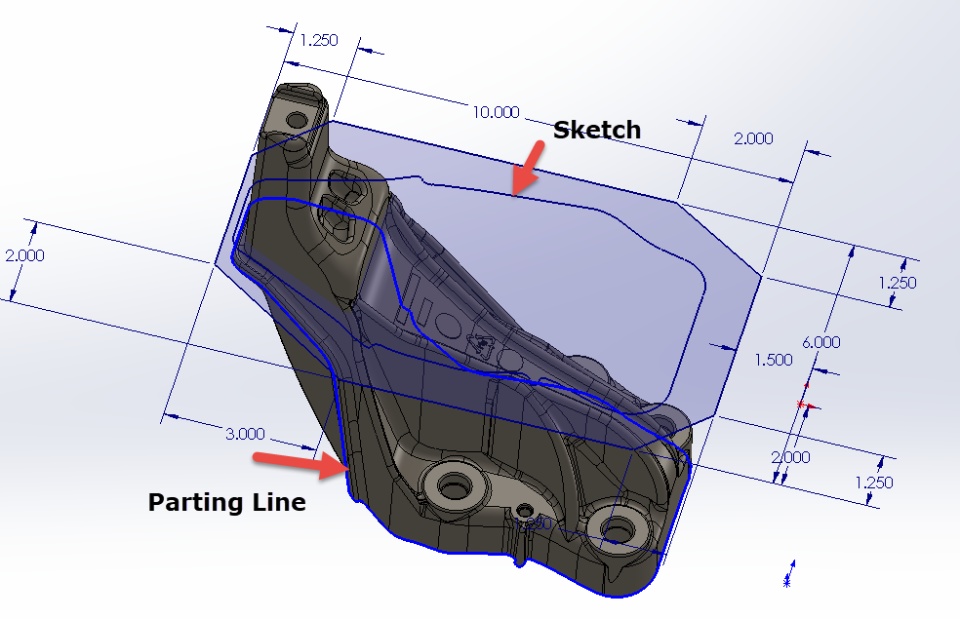

I do a lot of trim die design and most of the parts do not have a planar parting line. It would be very helpful if the parting line could be converted to sketch entities on a plane but I don't know if that is possible. Can anyone confirm this? The sketch in the picture was created by converting the edges of the part one by one which can be very tedious and difficult to generate a contiguous sketch. It would be so much easier to just select the parting line and click convert.

Those surface edges ARE the parting line. They EXCLUSIVELY are available for selection as a result of the parting line feature. Doesn't matter how it is achieved (try on a solid, it doesn't work). How was the parting line created? (hint: by selecting those same edges..) The blue line is just visual que for dummies who don't know how to use draft analysis or can't visualize spatially.

Technically we are not converting the parting line to a sketch as Richard Gergely pointed out, but we are essentially accomplishing the same thing. Thank you Newell for your suggestion. I tried it and it works. You have made my life easier. Ask and you shall receive. Thanks again.

If we look at the question it was can the PL be converted and the answer is still no. What you are actually doing is selecting the edge of surfaces to recreate the PL which is what essentially the OP already does just without the inclusion of select loop.
Looking at the parting line representation this could be by a non-editable blue 3D curve. Solidworks chose not to do it that way.

Well the question wasn't about making sense of why, but rather can it be done. To understand why, you have to realize what the parting line feature actually does.
The parting line created in blue is nothing more than a visual representation of surface element boundaries created by the feature. It is not a sketch or even a curve really (why it doesn't display with curves but rather PL's only..) so there is nothing to convert. The only thing it does is generate the surface bodies from the solid geometry and thus the method I suggested IS essentially converting the PL.

Yes that method works to recreate it but it still doesn't make sense why you just can't pick the PL that is already created in blue.

It is possible. Launch a sketch, hide your PL, Solid bodies, and either cav/core surface bodies. RMB on the PL edge of the surface body shown, click "select open loop" and then convert.
