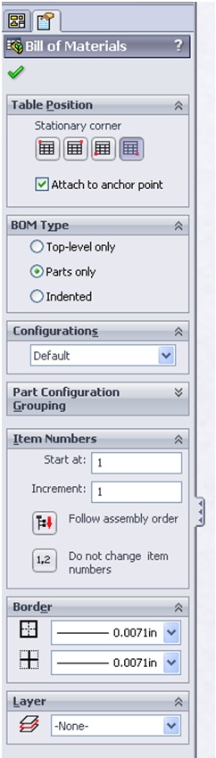

Right click upper left corner of BOM. Options be sure to select Parts only option.
