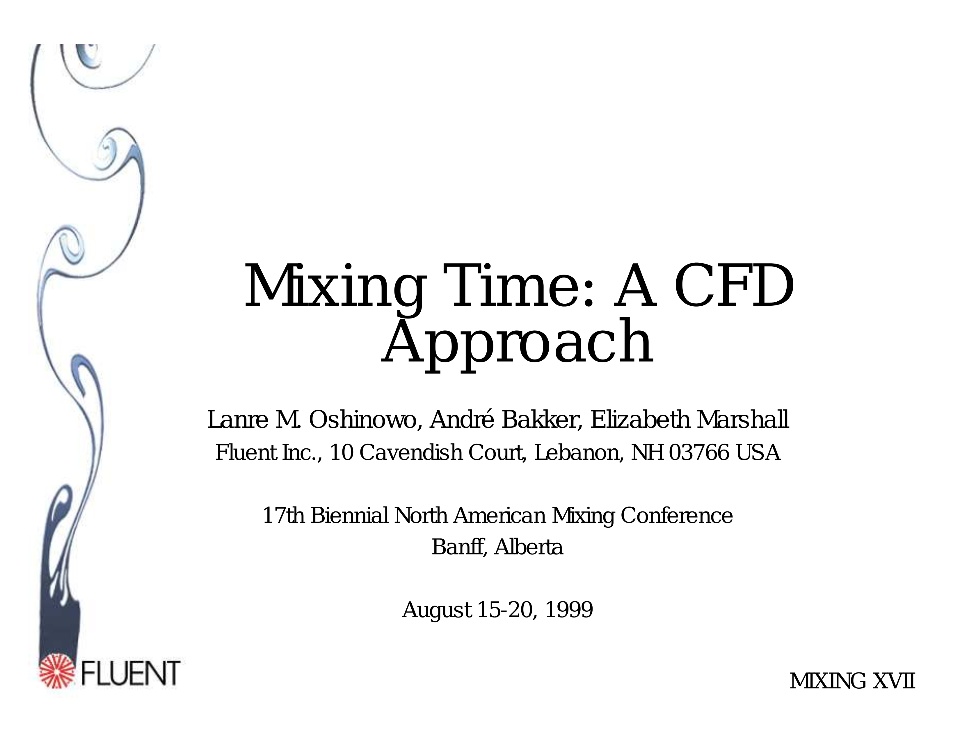

I have attached the Fluent presentation for reference to show what they can do.
