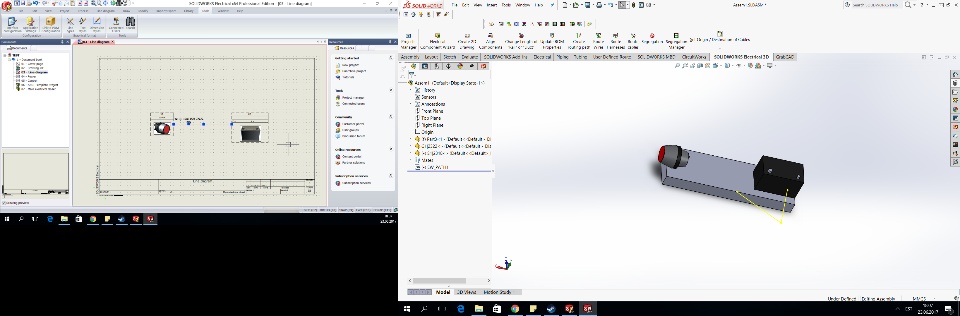

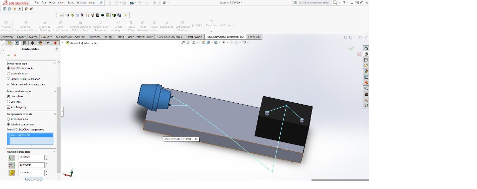

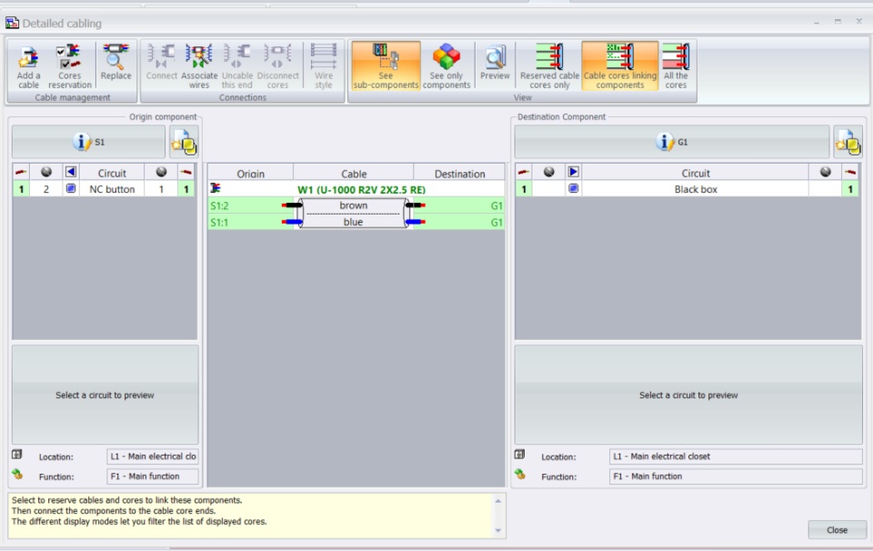

I am tryng to get cable routing working on one complex fusebox. As it wasn't working I made a simple button and battery assembly and there isn't cable routing working aswell. If I draw graph then it draws lines but it won't make cables. Can someone help me with that?

Is it possible that this cable or the related parts are specified as being part of a harness? We could check this by going to Project > Harnesses and seeing if they show up there. If they are part of a harness, we need to use the route harnesses command instead of route cables.
Other than that, we could check to make sure the component > 3D model association is correct and we could potentially remove the individual pin connections (leaving only the cable connection), just as a troubleshooting step.

Thank you for your reply. I messed around a little bit and I added components and cable to harness and then it worked with routing harnesses. However cable routing won't work. It works only if I assign empty assembly inside solidworks electrical, but if I open another assembly on my desktop it wont work. all associations are correct.
