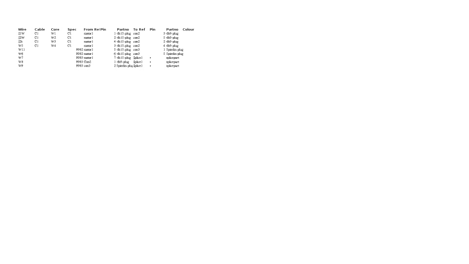

You are correct that flattening doesn't currently handle splices.  We are in the process of enhancing this.   We are changing it so that we use a part for the splice.  The part will have 1 CPoint.  It is then treated just as a connector and so will appear in the flattened model.  It'll also appear in the BOM.
To represent a splice in the fromto list you simply have the splice name as a ref designator and use '*' for the pin number.
Attached is an Excel version of such a fromto list - the same method is used in a xml version.
