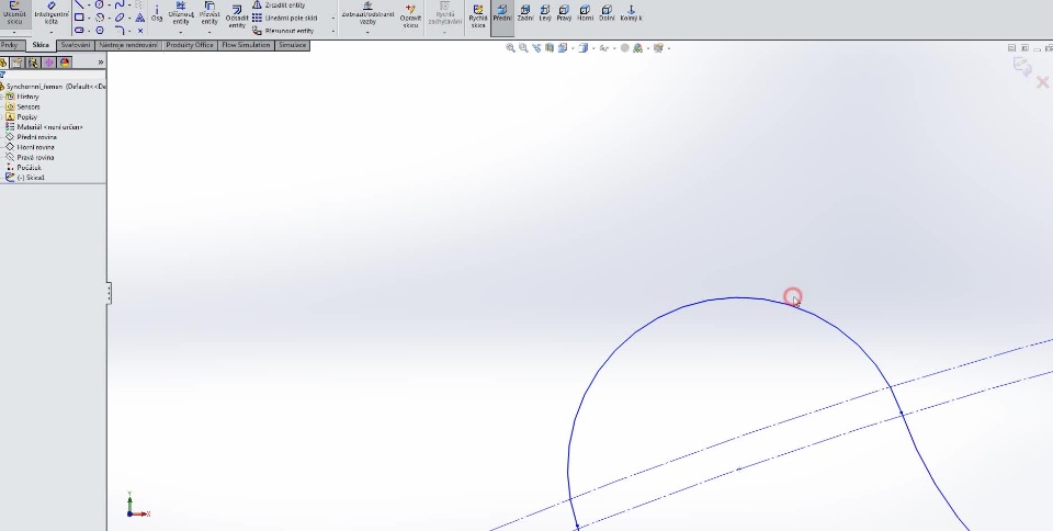

I have encountered an issue, using the SW 2014, and I would like to get Your opinion about it.
I bought a new WKS for purpouse of using SolidWorks:
MB: ASUS H97-PRO
CPU: Intel Xeon E3-1231v3
RAM: 16GB Crucial Ballistix Sport 1600MHz
GPU: Sapphire (AMD) FirePro W4100
3D mouse 3DConnexion SpaceNavigator for Notebooks with driver version 10.2.2
Solidworks 2014 SP4
win7-PRO x64
Curently I'm using certified driver 13.352.1009.
Since I bought a new wks, I have a problem with randomly (flashing) dis/appearing sketch while zooming in or out - during creating a sketch or working with 3D model. I got this on vid., dont worry, it is not a virus. (See Appendix)
I think this is not an issue regarding my gpu, I even tryed the old one - Ati Radeon HD4850 - problem remains (although the flashing wasn't on on the old WKS).
There is the same problem in a Software OpenGL mode.
After zooming in, the sketch seems to be a mooved a bit -> after that I can not pick any part of the sketch (video see Appendix)
Only the "Zoom All" helps in this case, but using the (Ctrl+Shift+Z) combo means reappearance of the bug.

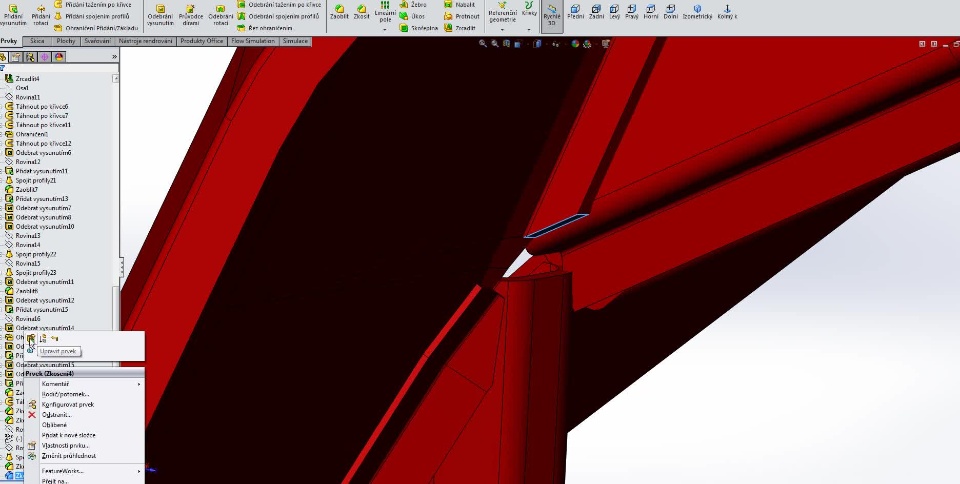

From time to time SW crashes, mostly during the movement of a model on a scene - once it happend while saving the model. SW crashed 8 times in 5 hours of work. I'm adding some SW generated messages after the crash - mostly one like the other. (error log  see Appendix)

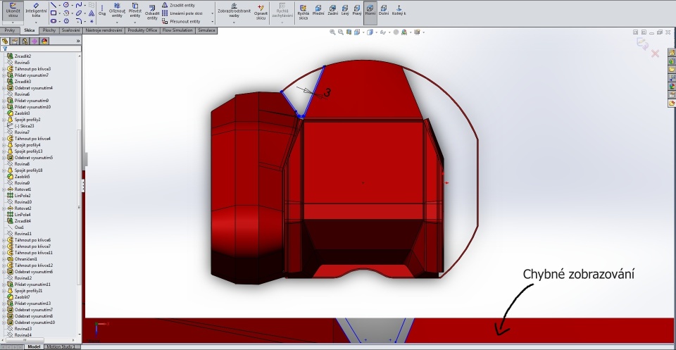

And one more thing – not a big deal, but still it bothers me: stucked image on the bottom of the window (video see Appendix)

I have been trying to work a bit and I found out, that SW crashes randomly – allways during the rotation of a model.
All it needs is to press a wheel button on a mouse and move it.
SW crashes like this even when the 3D mouse drivers were uninstalled.
Errors in displaying are still present (screen at the start of this thread).
SW crashes and displaying erros are quite unacceptable for a pc that is supposed to be a work station.

SF 2015-03-21
AERO mode has been responsible for errors in displaying.
After the transition to basic mode, everything works correctly.
Could these issues be solved differently, even with the AERO mode on?
