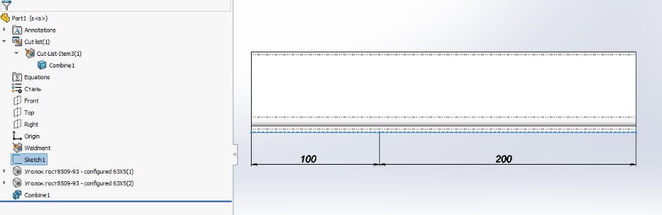

Hey Igor, why not make them in one weldment and use the merge built inside it?
IF
IF2018-02-28
There is no such option in my case
AL
AL2018-02-28
Are both of your line segments on the same sketch? Are they put in the same ''group''? inside the Weldment? Those could be reasons why the option isn't there.
IF
IF2018-02-28
Yes, Alex, These two segments are on the same sketch inside the weldment.
AL
AL2018-02-28
Hrm, it appears this function is only available when there is a corner treatment. I'm out of solutions, sorry.
IF
IF2018-02-28
Thank you and don`t worry, I wanted to report about a bug only.

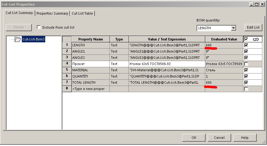

You are warned against doing this in the SOLIDWORKS help file:
IF
IF2018-02-28
OK, I understand that it's impossible to combine profile names or profile standards and so on, but it`s possible to get sum of mass or sum of lengths. I think it hasn`t to be a problem.
JS
JS2018-02-28
There is definitely a problem, but the help file is saying they know about the problem, but aren't doing anything about it. It gets the right length, sometimes. For angles less than or equal to 90, the length is reported correctly. For angles greater than 90, the reported length is incorrect and gets worse as you approach 180, where it is double what it should be. After 180, the discrepancy shrinks again until you hit 270 where the length is correct.
GS
GS2018-02-28
I'd guess they aren't doing anything about it because if they're identical profiles there's no reason (that I can think of) to ever need to combine bodies. Why not just create it as a single body in the first place?

I can understand why you might want to combine bodies. Eg. the sketch/sketches might be created by some kind of automation and in some cases end up with two coincident lines.
I tried to create your feature tree exactly from scratch (2017 SP3.0), and I could not reproduce your error. I used a default profile though, so the problem might somehow lie in the profile, not the path. Who knows?
IF
IF2018-03-01
I used SWX18.2, one line sketch which consist of two collinear segments. There is no difference between one or two groups.
SL
SL2018-03-01
SPR #:
1013891
Product:
SolidWorks
Status:
Open
Fixed in:
none none
Area:
Drawings
Sub-Area:
Tables - General
Customer Impact:
Medium
Enhancement:
Yes
Summary:
BOM and Weld Table - Weld bodies from the same section, but with different length - The 'LENGHT' parameter shows wrongly the same total length value for any cut-list items
IF
IF2018-03-01
Thank you very much

Hi Jim,
I think this is a good example of SW making user aware of a limitation. So I wouldn't use the term "bug".
The whole scenario can be easily dealt with in many other ways.
- Delete one of the bodies plus convert face contour extrude to point & merge
- Use trim tool with "extend option" and select end face of body that needs to be merged with then delete that body afterwards.
- Edit the original feature and include the path of the second body if possible
I would even say that's a much cleaner approach since you could change one profile to a different size when you use combine.
