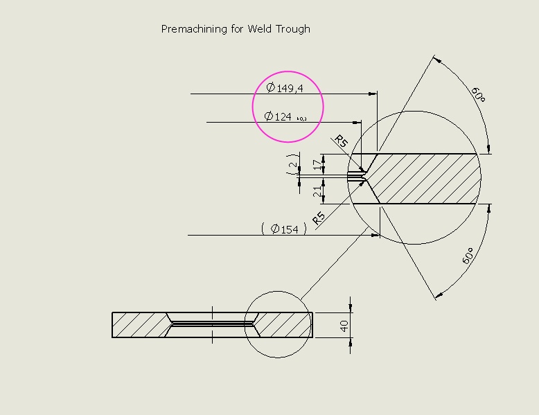

Look what I did in SW 2009, created a broken dimension line but I don't know how it works in SW2010 SP3.1.
Shift LMB didn't work to move the dimension to another view...
Anybody ?

those are not broken dimensions - no "squiggle" in the line. looks more like the extension line and arrow were hidden.

You're right Jeremy, but I like to know how to repeat this.
Suggestions ?

rmb, hide extension line, rmb, hide dimension line.

The issue is that I can only select 'one side' of the dimension... where can i select the other side.
As described in my first message shift LMB didn't work for the views...
Options ?
