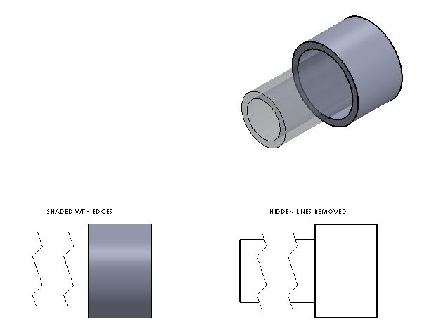

I'm having a problem breaking items that are transparent in drawings.
All transpart items seem to disapear even if they are not in the broken fiield.
