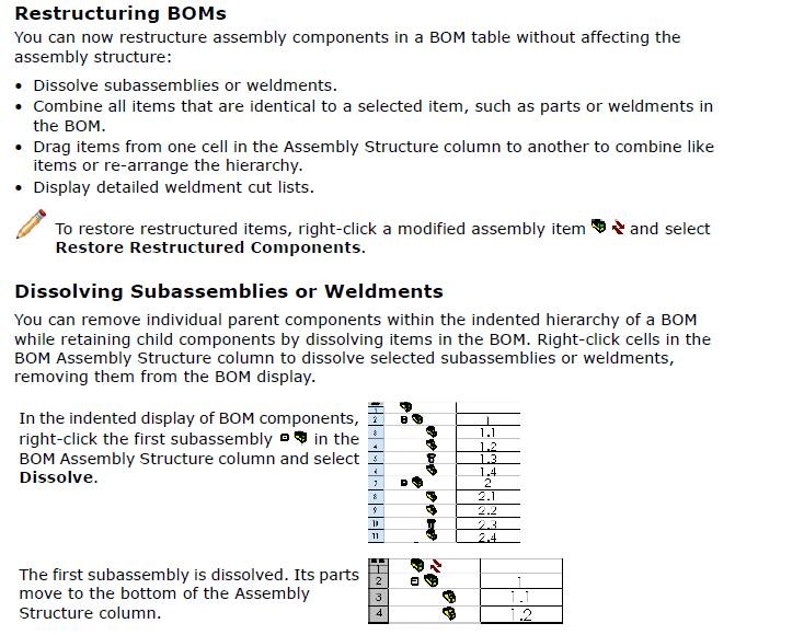

BS
BS 2010-06-15
Scott,
Not sure this is what you are looking for but starting in 2009 you can restructure you BOM without affecting you subs.  See attached image from the 2009 what's new.

BS
BS 2010-06-15
Unfortunately  I do not.  We are still on 2007 and implementing 2010 in August.  I remember seeing it in the What's New.  I think if you Ctrl select the items you want to be on there is a combine or group or something of that effect.
Sorry I do not have any specifics.
Bill
